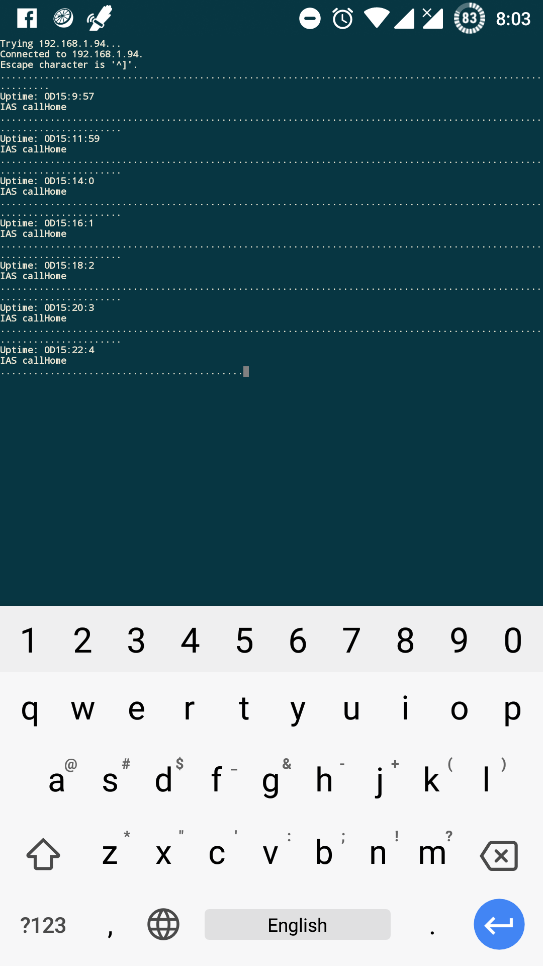

Příspěvek od mpca86 » 29 dub 2018, 13:08
aktuálne mám tento kód:

  TelnetServer.begin();
  TelnetServer.setNoDelay(true);
void loop(void) {
  uptime();                                                       //Runs the uptime script located below the main loop and reenters the main loop
  handleTelnet();
  IAS.buttonLoop();                                               // this routine handles the reaction of the Flash button. If short press: update of sketch, long press: Configuration
  if (millis() - callHomeEntry > (callHomeTimeout * 1000)) {
    unsigned long startcallHome = millis();
    print_Uptime();
    Telnet.println("IAS callHome");
    IAS.callHome();
    callHomeDuration = millis() - startcallHome;
    callHomeEntry = millis();
  if (millis() - sendDataEntry > (sendDataTimeout * 1000) - sendDataDuration + callHomeDuration) {
    print_Uptime();
    Telnet.println("Send Data");
    sendData();
    sendDataEntry = millis();
  if (uv.readIR() == 0) {
    print_Uptime();
    Telnet.println("ESP Restart");
    ESP.restart();
  Telnet.print(".");
  delay(1000);

No viď príloha neviem ani za pána prísť na to prečo mi nechce odosielať údaje. Vedel by mi niekto s tým pomôcť? :oops: :roll: :?: ĎAKUEJM
