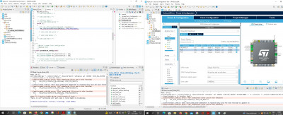

Já nevím kde dělám chybu? snažím se postupovat podle té knihy ,samozřejmě s ohledem na jinou desku v mém případě STM32-VL DISCOVERY trávím u toho 2 hodiny a pálím elektriku desktop žere, na notebooku nemám na SSD místa abych si mohl hrát celý den je to rozdíl v spotřebě desktop "pálí" 80 W a notebook do 30 W díky
14:07:40 **** Incremental Build of configuration Debug for project Kniha_LED ****
make -j4 all
arm-none-eabi-gcc "../Core/Src/main.c" -mcpu=cortex-m3 -std=gnu11 -g3 -DDEBUG -DUSE_HAL_DRIVER -DSTM32F100xB -c -I../Core/Inc -I../Drivers/STM32F1xx_HAL_Driver/Inc -I../Drivers/STM32F1xx_HAL_Driver/Inc/Legacy -I../Drivers/CMSIS/Device/ST/STM32F1xx/Include -I../Drivers/CMSIS/Include -O0 -ffunction-sections -fdata-sections -Wall -fstack-usage -MMD -MP -MF"Core/Src/main.d" -MT"Core/Src/main.o" --specs=nano.specs -mfloat-abi=soft -mthumb -o "Core/Src/main.o"
../Core/Src/main.c: In function 'main':
../Core/Src/main.c:96:22: error: 'PC8' undeclared (first use in this function)
96 | HAL_GPIO_WritePin(PC8,LD4[Blue], GPIO_PIN_RESET);
../Core/Src/main.c:96:22: note: each undeclared identifier is reported only once for each function it appears in
../Core/Src/main.c:96:26: error: 'LD4' undeclared (first use in this function)
../Core/Src/main.c:96:30: error: 'Blue' undeclared (first use in this function)
make: *** [Core/Src/subdir.mk:34: Core/Src/main.o] Error 1
"make -j4 all" terminated with exit code 2. Build might be incomplete.
14:07:41 Build Failed. 4 errors, 0 warnings. (took 471ms)

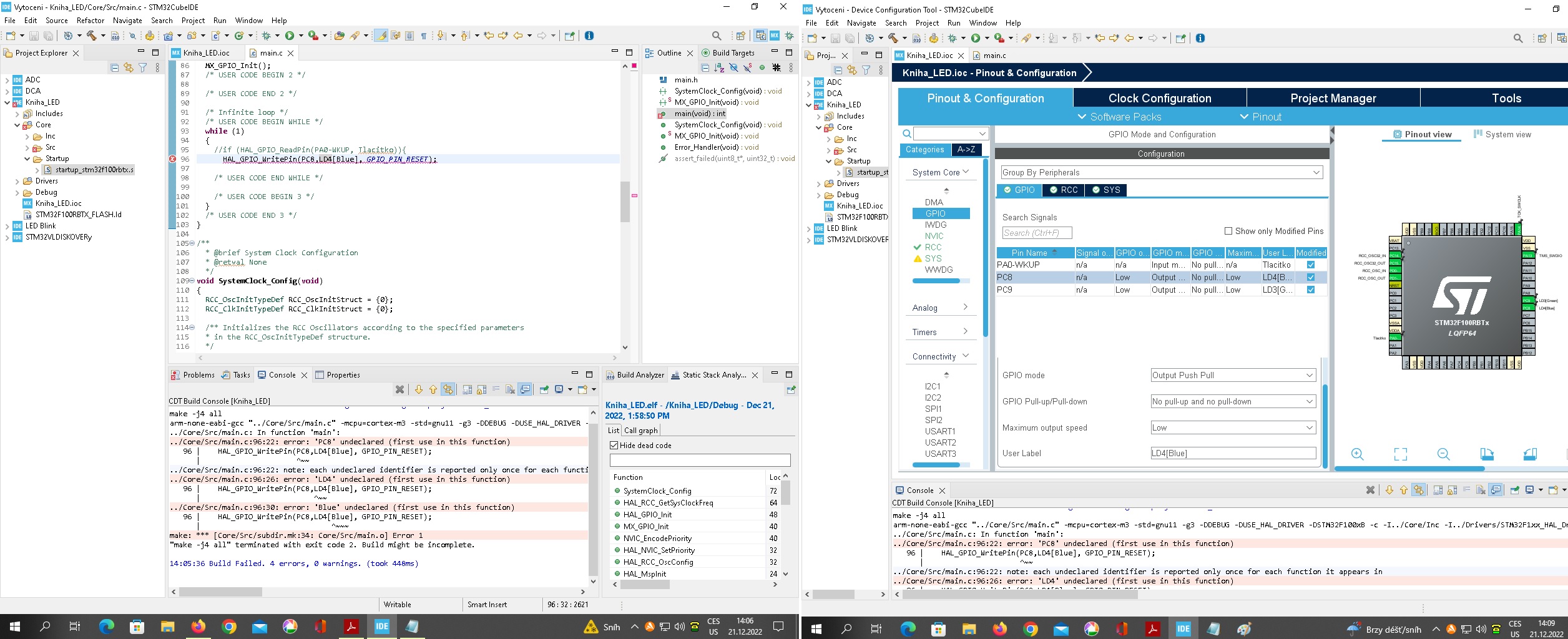

Re: STM32CubeIDE programování
21:19:36 **** Incremental Build of configuration Debug for project Kniha_LED ****
make -j4 all
../Core/Src/main.c:96:22: error: 'LD4_BLUE_GPIO_Port' undeclared (first use in this function); did you mean 'LD4_GPIO_Port'?
96 | HAL_GPIO_WritePin(LD4_BLUE_GPIO_Port, LD4_BLUE_Pin, 0); //pin do L
| LD4_GPIO_Port
../Core/Src/main.c:96:42: error: 'LD4_BLUE_Pin' undeclared (first use in this function)
21:19:37 Build Failed. 3 errors, 0 warnings. (took 1s.454ms)Re: STM32CubeIDE programování
A přejmenoval jsi si ty piny? Jestli ne, tak znovu v CubeIDE otevři CubeMX (poklepat na soubor konfigurace jmenoprojektu.ioc ), tam to změň a ulož (Ctrl+S). Pak zkus zase přeložit.
