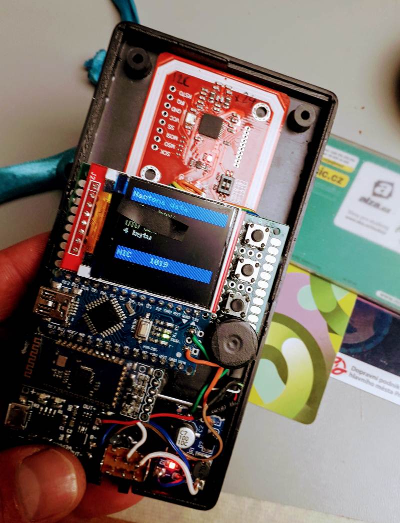

je to sice pro RC532 a je to ultra pokus jen pro cteni UID a jeho posilani po bluetooth, ale cte litacku, fio, isic schollar...
/* NFC reader with color display and bluetooth link (serial echo) to android phone
 * selfedu project for arduino nano, under GNU/GPL
 * version 0.5, demo, 03/2019.
 * Arduino NANO - packet version
 * SPI disp, I2C PN532, BT HC04, keyboard via A0
