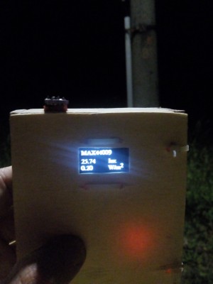

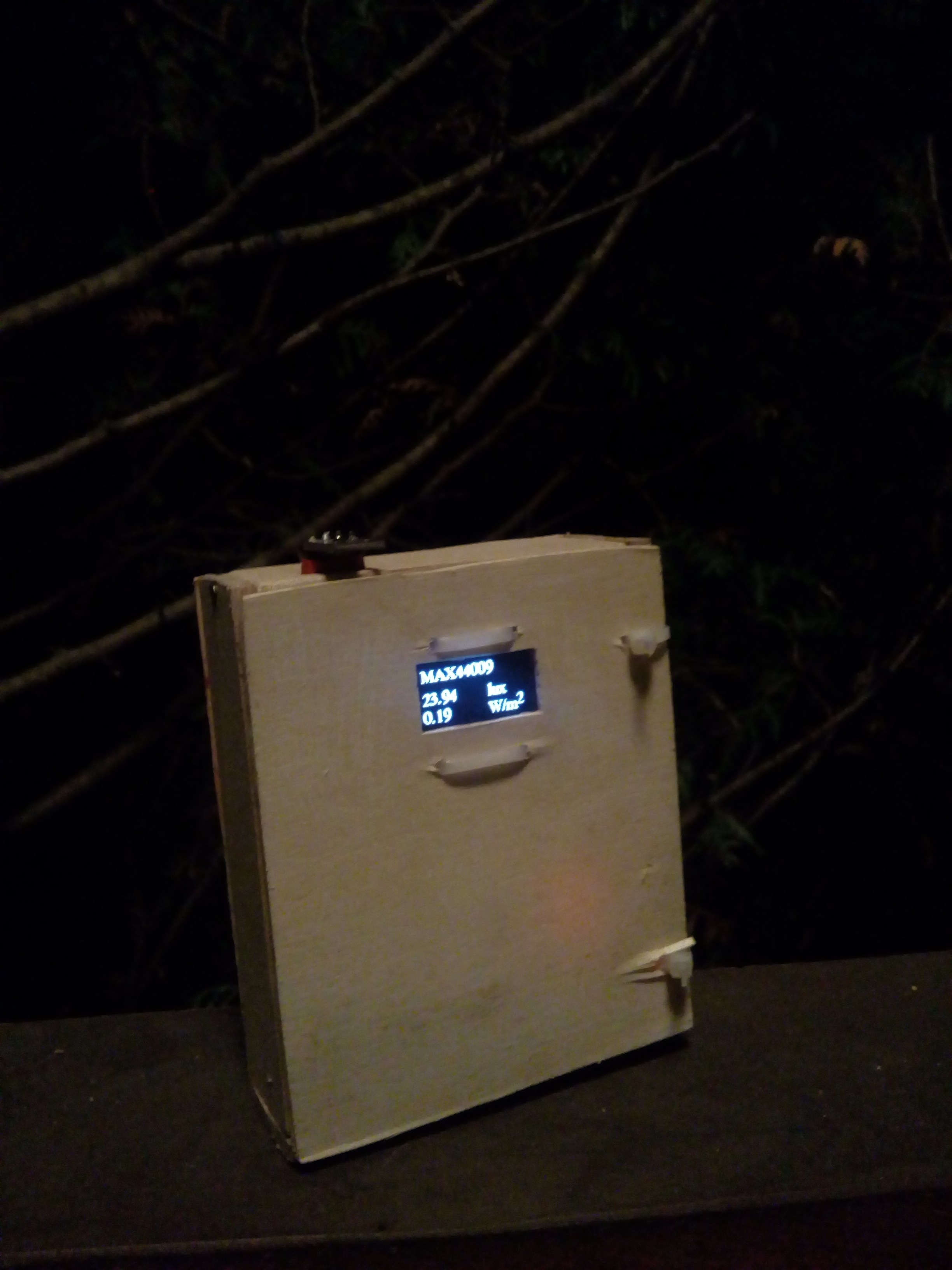

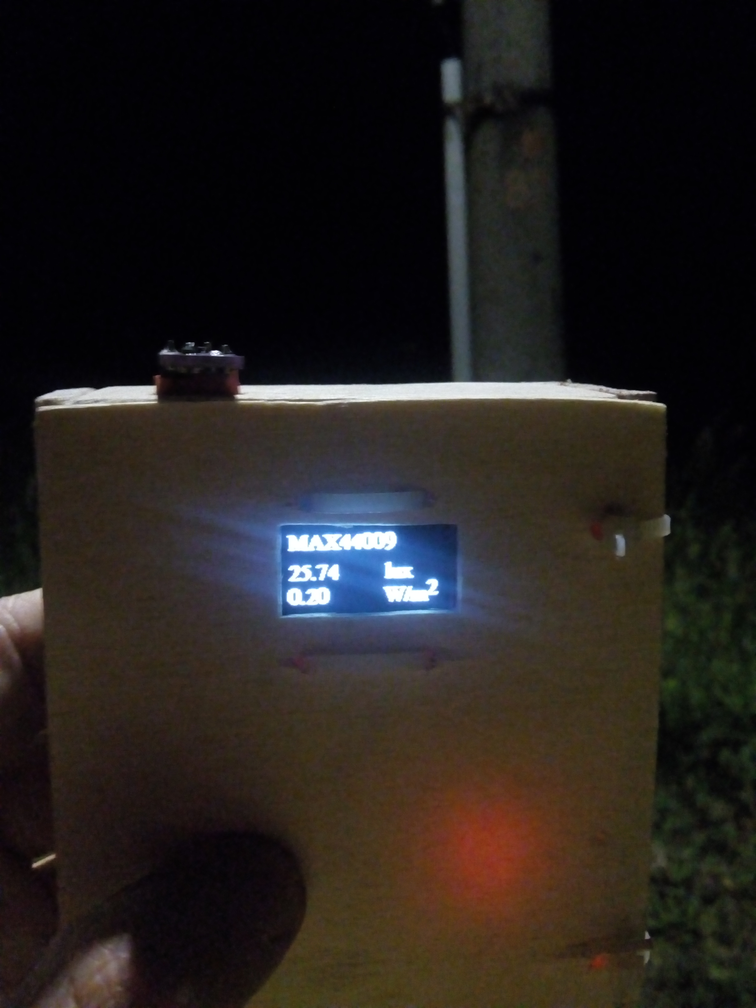

Zdravím, postavil som si vlastný luxmeter https://www.instructables.com/id/Portable-Luxmeter/.

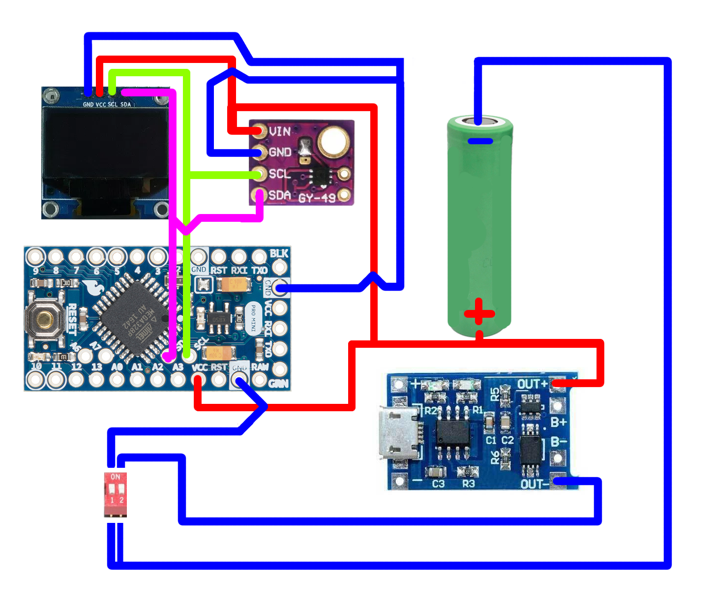

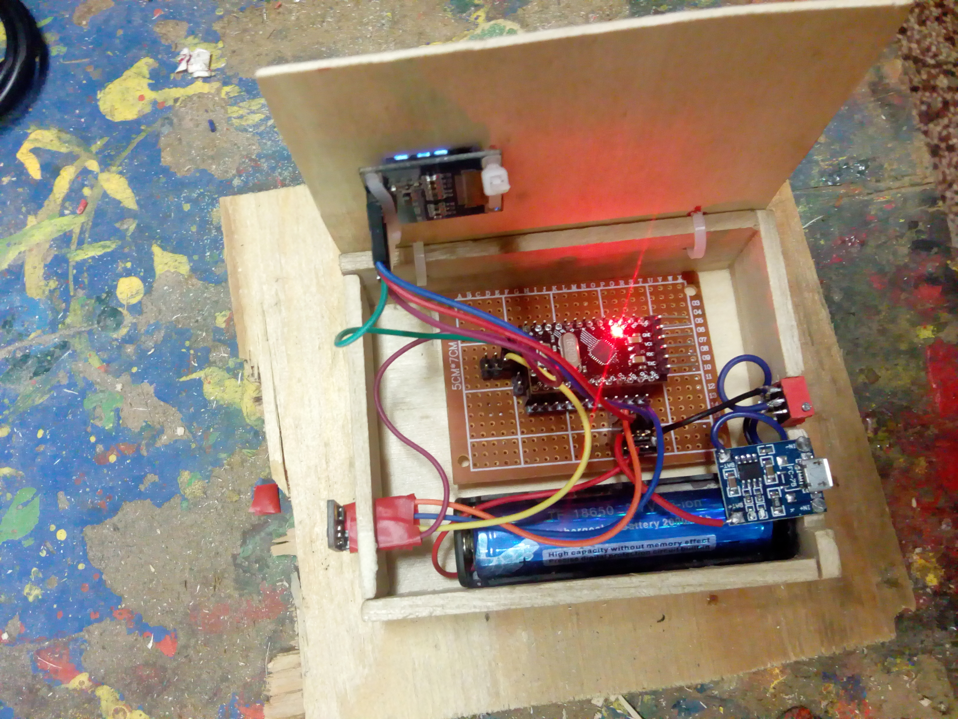

Meranie pomocou senzoru MAX44009, základ Arduino Pro Mini (osobne si myslím že je lepší Arduino Nano), bateria 18650, nabíjačka TP4056.
Cena 13 $ cca 333 Czk. Odber 15 mA.
BOM:
Arduino Pro Mini 5V
Link: https://www.aliexpress.com/item/3290014 ... c7f0a9951a
MAX44009
0.045 Lux to 188,000 Lux Range
VCC = 1.7V to 3.6V
ICC = 0.65µA Operating Current
-40°C to +85°C Temperature Range
Link
https://www.aliexpress.com/item/3282862 ... c7f0a9951a
OLED display
Link: https://www.aliexpress.com/item/3283585 ... c7f0a9951a
Diagonal Screen Size:0.96"
Number of Pixels:128 x 64
Color Depth:Monochrome (Yellow&Blue)
Dimension:27.8 x27.3x 4.3 mm
Working Voltage: 3.3~ 5V DC
Power: 0.06W
MaxViewing Angle: >160 Degree
Duty:1/32Brightness ( cd/m2):150 (Typ) @ 5V
Interface: I2C

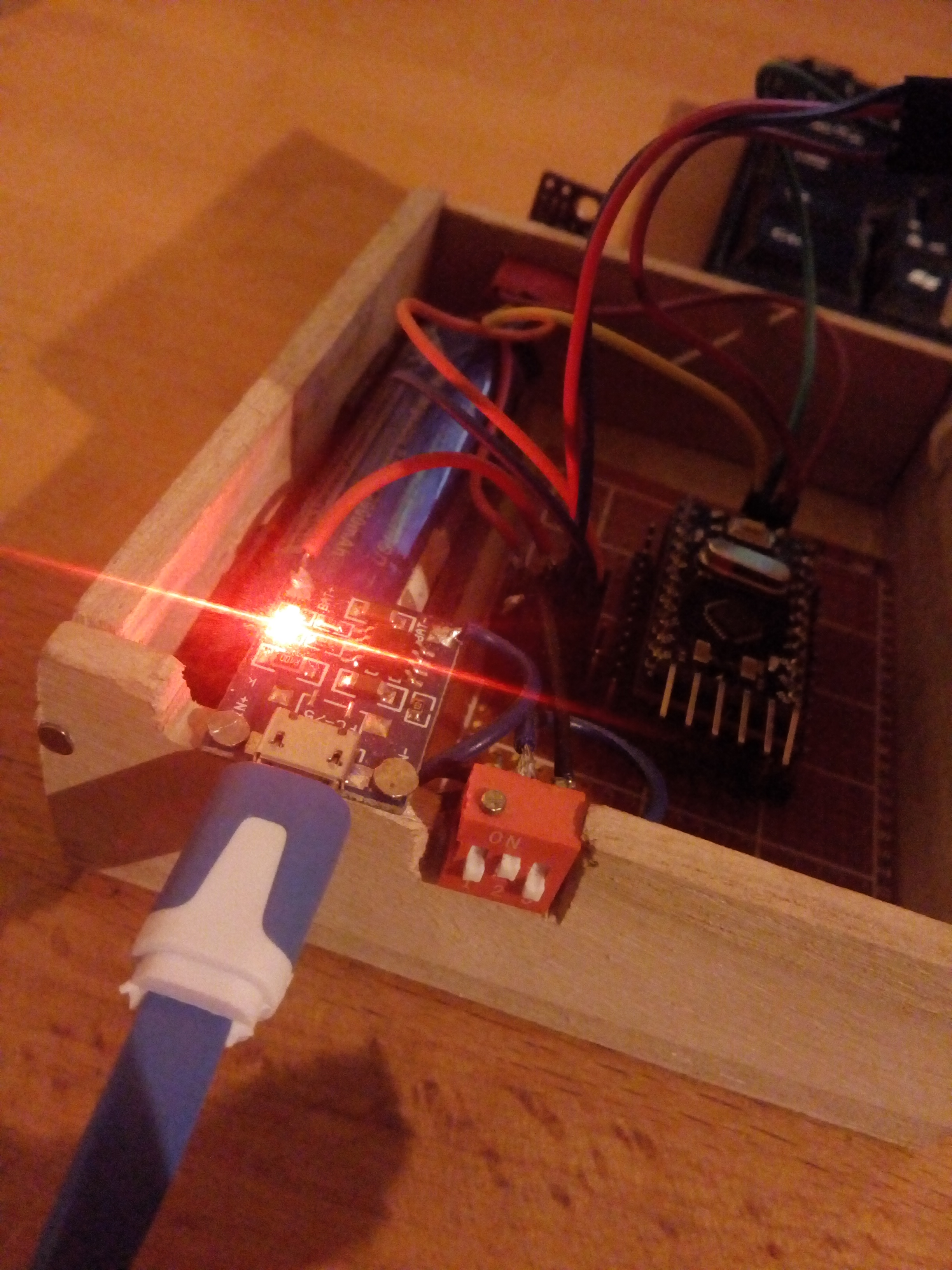

TP4056
input 5V
Link: https://www.aliexpress.com/item/3245305 ... c7f0a9951a
Li-Ion battery
3 - 4.2 V
Link: https://www.aliexpress.com/item/3280703 ... c7f0a9951a
18650 holder
Link: https://www.aliexpress.com/item/3265518 ... c7f0a9951a
Switch jumper
Link: https://www.aliexpress.com/item/3292600 ... c7f0a9951a
Dupont káble a pin headers
Link: https://www.aliexpress.com/item/3288083 ... c7f0a9951a
pin headers
Link: https://www.aliexpress.com/item/3269397 ... c7f0a9951a
