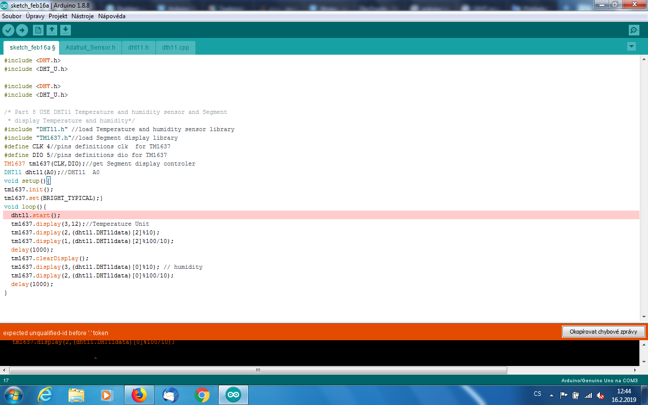

super díky moc, knihovny se povedlo vyřešit, teď to hlási zase nějakou jinou chybu
In file included from C:\Users\ceiroon\Desktop\sketch_feb16a\sketch_feb16a\sketch_feb16a\sketch_feb16a\sketch_feb16a\sketch_feb16a\sketch_feb16a\sketch_feb16a\sketch_feb16a\sketch_feb16a\sketch_feb16a.ino:1:0:
C:\Users\ceiroon\Documents\Arduino\libraries\DHT_sensor_library/DHT.h:32:15: error: expected unqualified-id before numeric constant
#define DHT11 11
C:\Users\ceiroon\Desktop\sketch_feb16a\sketch_feb16a\sketch_feb16a\sketch_feb16a\sketch_feb16a\sketch_feb16a\sketch_feb16a\sketch_feb16a\sketch_feb16a\sketch_feb16a\sketch_feb16a.ino:14:1: note: in expansion of macro 'DHT11'
DHT11 dht11(A0);//DHT11 A0
C:\Users\ceiroon\Desktop\sketch_feb16a\sketch_feb16a\sketch_feb16a\sketch_feb16a\sketch_feb16a\sketch_feb16a\sketch_feb16a\sketch_feb16a\sketch_feb16a\sketch_feb16a\sketch_feb16a.ino: In function 'void loop()':
sketch_feb16a:21:8: error: expected unqualified-id before '.' token
dht11.start();
sketch_feb16a:23:26: error: expected primary-expression before '.' token
tm1637.display(2,(dht11.DHT11data)[2]%10);
sketch_feb16a:24:26: error: expected primary-expression before '.' token
tm1637.display(1,(dht11.DHT11data)[2]%100/10);
sketch_feb16a:27:26: error: expected primary-expression before '.' token
tm1637.display(3,(dht11.DHT11data)[0]%10); // humidity
sketch_feb16a:28:26: error: expected primary-expression before '.' token
tm1637.display(2,(dht11.DHT11data)[0]%100/10);
Byly nalezené násobné knihovny "DHT.h"
Použitý: C:\Users\ceiroon\Documents\Arduino\libraries\DHT_sensor_library
Nepoužitý: C:\Users\ceiroon\Documents\Arduino\libraries\Grove_Temperature_And_Humidity_Sensor
Nepoužitý: C:\Users\ceiroon\Documents\Arduino\libraries\DHT-sensor-library-master
exit status 1

Dej sem raději celý tvůj kod. To co máš na obrázku je špatně, používej knihovnu dht11.h nebo DHT.h zbytečně načítáš obě, když používáš jen jednu. Pin A0 jako vstup pro čidlo raději nepoužívej, čidlo nemá analogový výstup.
