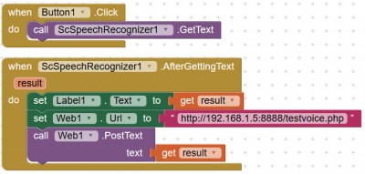

Ja našel toto.
https://groups.google.com/g/mitappinven ... AwAJ?pli=1

<?php
$data = file_get_contents('php://input');
file_put_contents('./shm/testvoice', $data);
