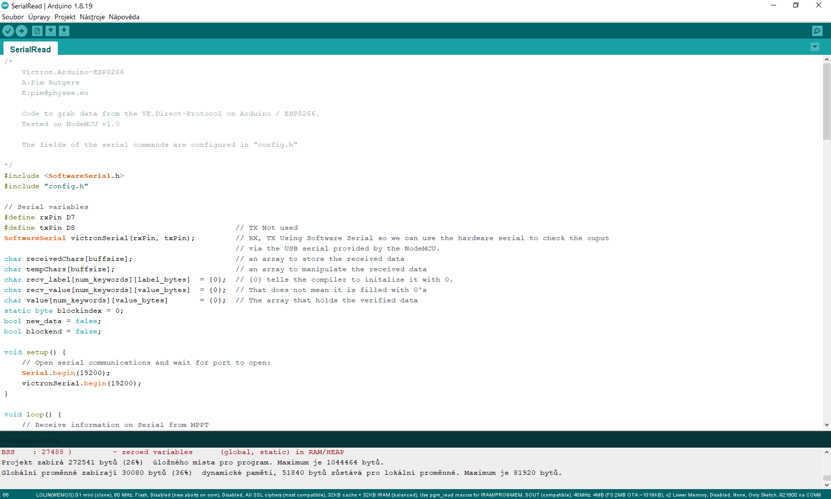

Tak jsem zjistil ze ten kod co jsem posilal je pro AVR architekturu...
Ale nasel jsem i pro ESP8266 https://github.com/physee/Victron.Arduino-ESP8266
ale stale se nemuzu pohnout
a stále chyby :
A:Pim Rutgers
E:pim@physee.eu
Code to grab data from the VE.Direct-Protocol on Arduino / ESP8266.
Tested on NodeMCU v1.0
The fields of the serial commands are configured in "config.h"
#include <SoftwareSerial.h>
#include "config.h"
// Serial variables
#define rxPin D7
#define txPin D8 // TX Not used
SoftwareSerial victronSerial(rxPin, txPin); // RX, TX Using Software Serial so we can use the hardware serial to check the ouput
// via the USB serial provided by the NodeMCU.
char receivedChars[buffsize]; // an array to store the received data
char tempChars[buffsize]; // an array to manipulate the received data
char recv_label[num_keywords][label_bytes] = {0}; // {0} tells the compiler to initalize it with 0.
char recv_value[num_keywords][value_bytes] = {0}; // That does not mean it is filled with 0's
char value[num_keywords][value_bytes] = {0}; // The array that holds the verified data
static byte blockindex = 0;
bool new_data = false;
bool blockend = false;
// Open serial communications and wait for port to open:
victronSerial.begin(19200);
// Receive information on Serial from MPPT
RecvWithEndMarker();
HandleNewData();
// Just print the values every second,
// Add your own code here to use the data.
// Make sure to not used delay(X)s of bigger than 50ms,
// so make use of the same principle used in PrintEverySecond()
// or use some sort of Alarm/Timer Library
PrintEverySecond();
// Serial Handling
// This block handles the serial reception of the data in a
// non blocking way. It checks the Serial line for characters and
// parses them in fields. If a block of data is send, which always ends
// with "Checksum" field, the whole block is checked and if deemed correct
// copied to the 'value' array.
void RecvWithEndMarker() {
static byte ndx = 0;
char endMarker = '\n';
char rc;
while (victronSerial.available() > 0 && new_data == false) {
rc = victronSerial.read();
if (rc != endMarker) {
receivedChars[ndx] = rc;
ndx++;
if (ndx >= buffsize) {
ndx = buffsize - 1;
else {
receivedChars[ndx] = '\0'; // terminate the string
ndx = 0;
new_data = true;
yield();
void HandleNewData() {
// We have gotten a field of data
if (new_data == true) {
//Copy it to the temp array because parseData will alter it.
strcpy(tempChars, receivedChars);
ParseData();
new_data = false;
void ParseData() {
char * strtokIndx; // this is used by strtok() as an index
strtokIndx = strtok(tempChars,"\t"); // get the first part - the label
// The last field of a block is always the Checksum
if (strcmp(strtokIndx, "Checksum") == 0) {
blockend = true;
strcpy(recv_label[blockindex], strtokIndx); // copy it to label
// Now get the value
strtokIndx = strtok(NULL, "\r"); // This continues where the previous call left off until '/r'.
if (strtokIndx != NULL) { // We need to check here if we don't receive NULL.
strcpy(recv_value[blockindex], strtokIndx);
blockindex++;
if (blockend) {
// We got a whole block into the received data.
// Check if the data received is not corrupted.
// Sum off all received bytes should be 0;
byte checksum = 0;
for (int x = 0; x < blockindex; x++) {
// Loop over the labels and value gotten and add them.
// Using a byte so the the % 256 is integrated.
char *v = recv_value[x];
char *l = recv_label[x];
while (*v) {
checksum += *v;
v++;
while (*l) {
checksum+= *l;
l++;
// Because we strip the new line(10), the carriage return(13) and
// the horizontal tab(9) we add them here again.
checksum += 32;
// Checksum should be 0, so if !0 we have correct data.
if (!checksum) {
// Since we are getting blocks that are part of a
// keyword chain, but are not certain where it starts
// we look for the corresponding label. This loop has a trick
// that will start searching for the next label at the start of the last
// hit, which should optimize it.
int start = 0;
for (int i = 0; i < blockindex; i++) {
for (int j = start; (j - start) < num_keywords; j++) {
if (strcmp(recv_label[i], keywords[j % num_keywords]) == 0) {
// found the label, copy it to the value array
strcpy(value[j], recv_value[i]);
start = (j + 1) % num_keywords; // start searching the next one at this hit +1
break;
// Reset the block index, and make sure we clear blockend.
blockindex = 0;
blockend = false;
void PrintEverySecond() {
static unsigned long prev_millis;
if (millis() - prev_millis > 1000) {
PrintValues();
prev_millis = millis();
void PrintValues() {
for (int i = 0; i < num_keywords; i++){
Serial.print(keywords[i]);
Serial.print(",");
Serial.println(value[i]);
}Kód: Vybrat vše

Vem si tohle, co už máš
Spusť na tom Arduino IDE. Musíš však přidat soubor config.h do projektového adresáře k souboru SerialRead.ino
Pak se to bez chyb a problémů přeloží. Pochopitelně musíš nastavit odpovídající desku. Pokud budeš mít nějaký další problém, dej vědět. Jestli je ovšem program opravdu funkční s Victronem netuším. Taky nevím, s jakými úrovněmi napětí Victron na RS232 pracuje, na to pozor. A ještě bys v tom souboru config.h měl tuším definovat správný model toho Victronu. Teď je #define MPPT_75_10

Povedlo se mi to tam nahrat, ale jak uklozit do promene jen urcitou hodnotu ?? Nyni je tam vse... a vypisuje se vse naraz... potrebuji vypsat jen aktualni vyrobu ve W ze solaru, potom do druhe promenne aktualni odber z baterek.
