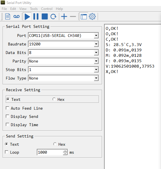

TAKTO TO VYPADA KED SOM PRIPOJENY NA PC CEZ USB TTL
PRIKAZY: TO CO JE ZA DVOJBODKOU JE ODPOVED
O
C
S
D
M
F
V
X
